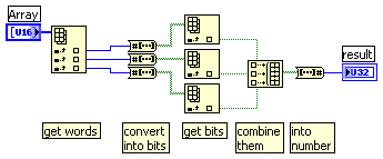

extract some bits ina byte that add to another byte
i want to extact some bits form different bytes and making these bits into byte how to that one plese help me

Hi jabili,
the straight-forward solution might be:
- convert your numbers to bit-arrays (there's a special conversion function to do so)
- use "index array" to get the bits you need
- build a new array from these bits
- convert the resulting bit array back to a number (upto 32 bits)
(4,978 Views)
Hi jabili,
here is a picture:
It's not the most efficient way, but it should suit your needs...
