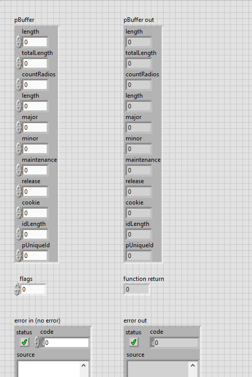

I have inherited a Mathlab DLL that is causing me a headache and wonder if anyone has a slolution.
labview crashes or gives error code 1097 and I beleive it maybe a call in the DLL called the RFID_RetrieveAttachedRadiosList Vi.

the DLL builder creates the Vi that seems correct
when ran, it give the wrong values with what looks like pointers inserted into the second length and major fields offsetting the data and not having enough room for all of it.
passing the results to the next Vi causes all sorts of mayhem from initially working, crashing, giving error 1097. Its very intermittant (memory issues).

Well, this uses pointers to structs, with pointers to structs that contain pointers to structs!!!!
To make this work in LabVIEW without external C code requires you to play low level C programmer, C compiler and a few more tricks. It's not worth it. You need to write a wrapper DLL in C(++) to translate this monster of a data struct into something more pallable for LabVIEW.

Thanks for you reply rolfk.
How exactly do I make such a wrapper?
Do I created a C function that calls the the RFID_.. function, containing a simplified parameter list?
Place the new wrapper C function into the same DLL as the RFID (not sure how)?
I then call ther wrapper instead of the function?
Robert
(4,350 Views)
That's basically the idea, except you create a new DLL with the wrapper functions, and those wrappers calls the functions in your original DLL. You don't modify the original DLL.
(4,340 Views)
Brilliant; That I can do, thank you very much Nathand
