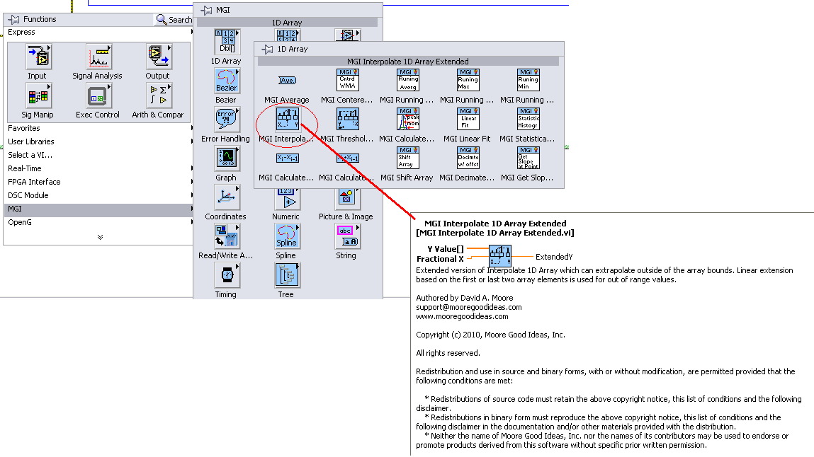

Hallo Jo Le
Thanks for your reply. I was trying to draw an overlay.. I used IMAQ Overlay function and now it works.
But i have another question now. I have the line coordinates for 2 lines and the intersection point. How can i extend both lines in both directions?  See the attachment. I need to find the Blue marked points. I cannot find an Extrapolation function. Any ideas ?
Nghtcwrlr
(3,267 Views)
Accepted by topic author Nghtcrwlr
I found the extrapolating function... I installed VIPM and installed the MGI package.
