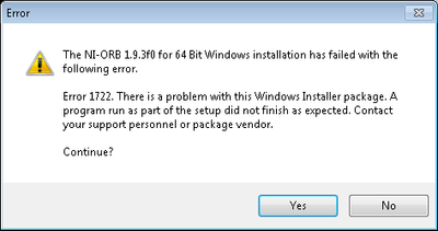

Hi to all,
I have installed labview2009 and its device drivers (32 bit version support) successfully on my computer running 64 bit on it.
I can create, load  and save any VIs through labview 2009. Thats great!
But the problem is with the device drivers.
Under device drivers, i have installed Measurement and Automation Explorer and NI Scope. (My areas of interest)
During its installation itself, several errors came. Neglecting those, I continued my installation.
When I am trying to create a simulated NI card through MAX, I can't. This is because it is not showing any option create a SIM card (This is my first experience facing such kind of problems).
What I suspect is, those drivers are not supporting 64 bit version.  But I am not sure.
Following are the snaps of those error messages during installation.
Please tell me solution for this. If i have to install 64 bit support version for those drivers, where do i get that?
Thanks and regards,
Sriram Iyer.

Hello Sriram,
Here's a list of product compatibility for Windows 7 32 bit and 64 bit.
National Instruments Product Compatibility for Microsoft Windows 7
