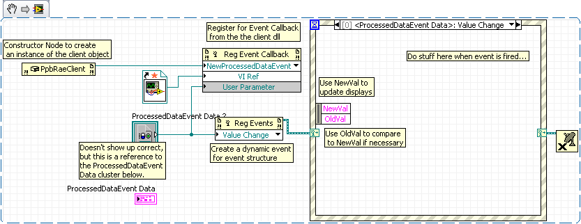

I had to figure this out for the .NET side of things.  It may help, not sure.
I started by creating an instance of the client object seen below.  In that client object there is an event that tells users when new data is available to be displayed.  To subscribe to that event I register for the Event callback from that object.  There is a lot more on this in the NI example finder if you search for NET Event Callback for Calendar Control.  This is where I learned how to do most of this.  I had to create a separate VI for the VI Ref and wired up a Reference to the data cluster as the user parameter.  Next I create a dynamic event for that data cluster.  If the value changes I want the event structure to do something for me.  I use the NewVal and OldVal for comparison.  At this point my front panel display is updated with any new information.
I am not sure if this will help but I know what it was like trying to figure out how to use an event from a DLL to trigger my LabVIEW VI.  Let me know if this helped or if you need me to clarify anything.
