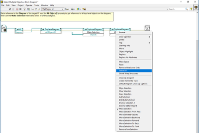

Hi Kartik, will this work for you?

I cannot see that option...
And your invoke node looks different.. How so??

I just needed to enable private class..
