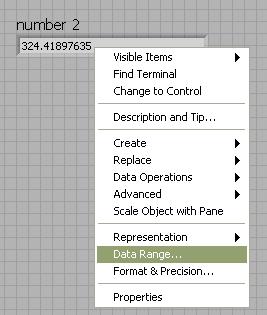

For reasons obvious to somebody, a decimal number has no decimal point.  I am guessing that the display format of your numeric indicator is not set to enough digits of precision.  Right-click and select display format to increase the precision.
Message 2 of 33
(18,441 Views)
Chack the properties of the Numeric indicator, by default it shows 6 significant digits. You'll want it to be 15 or so. The number is unaffected though, it's just a presentation thing.
/Y
Qestit Systems
Certified-LabVIEW-Developer

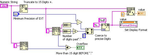

krd12 wrote:
I am trying to convert a string with a lot of digits (ex 324.41897635) into a number and want to get back the same precision in the number as in the string. I tried the "Decimal String to Number" (get back no digits after decimal point ex 324) and "Frac/Exp String to Number" (get back three decimal places rounded ex 324.419)
Not a trivial exercise!
Here is 1 possible solution I've limited it to non-trivial digits (ext floats are only 15 digits precise on some OS's.)  But you can see the steps necessary.  I assume the radix symbol is "." but the vi could be modified to use"System Decimal Seperator"
"Should be" isn't "Is" -Jay
Message 5 of 33
(18,375 Views)

 This should be close enough and slightly simpler.
Qestit Systems
Message 8 of 33
(18,349 Views)
