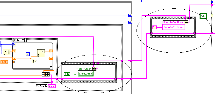

looking at this image. i think its safe for me to remove the flat sequence?
just making sure?
Message Edited by krispiekream on 08-05-2008 05:27 PM
Krispiekream
Message 4 of 25
(4,548 Views)
Certainly the one on the right. Dataflow assures that the while loop is finished before the Press to Continue executes and that will be done before the case structure at the left.
The one on the left? I cannot tell from the picture. The cluster wire coming in to the Bundle by Name comes around the inner case structure. If you put the True constant inside that case structure (all cases or wired through all cases), then neither the Bundle by Name nor the local variable would need to be in the sequence.
Lynn
