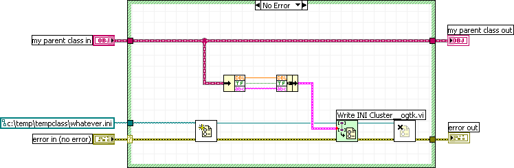

One thing that was always cool about GOOP was the ability to treat the data as a cluster. For example, one could write code to quickly spit the names and values of members out to an .INI file.
Im noticing with LVOOP, I can't get the cluster properties for the member cluster. Its driving my crazy because i use this feature quite a bit. The only workaround ican think of is to drop a strict type def'd cluster in as the data but thats a layer of just i dont want.

Having said all that, this sounds like a hybrid of both cases. Trying to get access to the data as a cluster *outside* of the class would be a major violation of the data privacy -- that would be exposing the implementation of the data to the world. Within the class, we do need an improved reflection API, although, as you pointed out, you could achieve the necessary behavior by using a strict typedef today within the class cluster.
Attached is a VI set that does what you asked for a class hierarchy without using a strict typedef. Open the project and then open DEMO.vi. I strongly suspect you won't be happy with the solution I've included, but perhaps something in there will help with your search for an acceptable solution.

I understand that what you want to do is not directly exposed in LVOOP, but it doesn't sound like the workaround would be very difficult at all. It would involve creating a member function for your class that would write the values to the ini file. You would be correct to point out that this would be difficult to do for any generic class without using member functions, but it is extremely easy to do for a specific class.
There are two ways you could implement this. First, have your private class data be a cluster that contains a typedef cluster. Then all your member VI has to do is unbundle the private data, retrieve the inner cluster and write that cluster to file. OpenG has a great utility for writing clusters to an ini file that doesn't involve control references. Or you could use your method and extract the inner cluster of the private data into a dummy control and use a reference to extract the data names and values.
If you don't want an extra cluster layer in your data type, it's not a lot of extra work. Just unbundle all the elements of the private class data in your member function, rebundle them into a cluster with the same types of controls, and then use that cluster to write the data to file. You would probably want to typedef this cluster that mirrors your private function data so you can read in the ini values.

That is exactly what Im trying to do. It seems like an awful lot of work to get more info about the data type.
What would be handy is if you could put a cluster within a member VI that had the same data type as the object. Currently, when you browse and select data.ctl from the class library, you get a class object, not its data type .ctl. Access to both would be cool.
Youve shown that the data type is indeed a cluster. The trick is getting that control open.
What I did with the GOOP model was copy the objects data into a temporary cluster, and use a function "ClusterRef to PV". Actually the real power of it was accomplished by making it recursive so that you could dump the configuration of an entire object hierarchy to a config file without writing a lick of code- Just pass it a reference to the Parent object.

Thanks, Jerrod. Taking your solution and combining it with mine, it should become straightforward to generate a solution that will handle the cluster at every level of inheritance.
