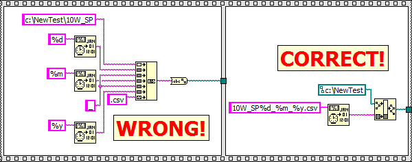

The "check if file or folder exists?" returns false when there is a folder in c drive. So I added a "create folder" if false. Now it returns true, but there is no file in c:
What could be the problem?

I meant after I create a folder, there is no folder( therefore no file too) in c drive.
Here is my code.
Message 4 of 23
(7,655 Views)

Hi kdm,
you didn't say where you checked for those folder(s) and file(s)…
But your "test2_rt (2).vi" shows a big, very big, HUGE problem:
You create a file path by using string constants. THAT'S PLAIN WRONG! Use path constants whenever you want to handle paths!

Hi Gerd,
Now I've changed it. Thanks.
But I'm still not able to find the log file. I checked it in c drive.
I use sbRIO 9641. How do you check whether it is on the sbRIO target?
There is small green circle on the "NI-sbRIO9641-01624006" line. It indicates that the device is connected and I have the VIs under them. Does that mean I'm on the sbRIO 9641 target?

Do you make sure to create the NewTest directory before writing to a file in it?
Do you check the error that CreateDirectory returns?
Do you check the error that Write to Spreadsheet file or whatever other function you use to write to the file does return?
Rolf Kalbermatter  My Blog
Message 9 of 23
(7,597 Views)
Hi rolfk,
Yes, I have the NewTest folder created.
No error returned from create folder
No error returned from Write to text file either.
