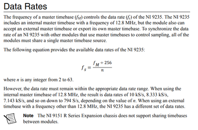

I have a NI 9235 equipment. I did a program with labview to record the data txt file. The minimum scan rate is 794 by default. How can I set the NI 9235 or the program labview so that I can register data with less scan rate  (for example 100 scan/s).

Hello Isaac,
See attached picture from NI 9235 datasheet:
It shows that the minimum sampling rate is 794 S/s with this module.

Hi isaac,
When you need less samples than 794S/s you need to decimate your samples…
