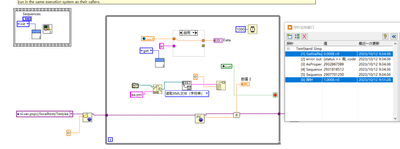

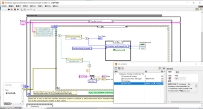

Hi Community,

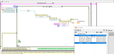

from the bottom picture,i can not read 'Local.a' in the sequence,but i can get the RunState,it seems the probe 1 is 0.
any suggestions welcome

Use SequenceFileViewManager

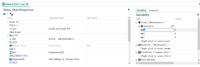

a=1(probe 6),but probe 1 is 0(with no error),is there something i missed?

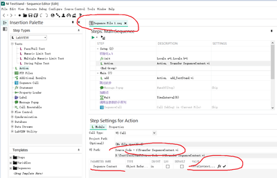

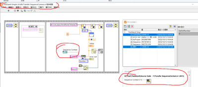

my goal is to get the SequenceContext by LabVIEW,then i can get data in the sequence.
until now i use stupid ways to get data in the sequence.

my goal is to get the SequenceContext by LabVIEW, then i can get data in the sequence.
Calling a VI from TestStand and giving ThisContext as a parameter is the preferred/recommended way, so why do you think this would be a "stupid way"?

XiaoJian,
You are using Operator Interface.  It's purpose is to run sequences.
Leave the data manipulation to sequences and their VIs.

And if you want to send simple data to your operator interface, then use User Messages.
