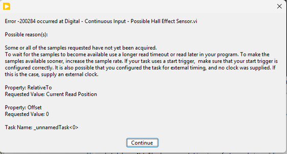

Okay, I switched it now, but when I run the sample code I still get this error:
Is it possible that the hall effect sensor is not drawing enough power?
This error has nothing to do with the wiring, but programming. See Error -200284: Samples Have Not Been Acquired
https://tmesystems.net/
Message 6 of 10
(302 Views)
That fixed the error, but I still am not getting any readings from the sensor. When I run the example code (Attached), I just get a straight line, and when I bring a magnet in front of the encoder it does nothing.
