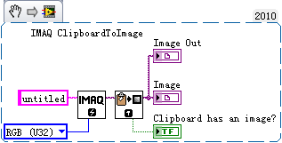

Hi all the repliers,
I find another solution that get the clipboard image. Hope it is helpful for next follower.
Use the IMAQ ClipboardToImage.vi under vision module, it can get the image successfully, but not verify it after build executable file.
Colin Zhang
