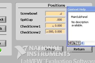

Here is another instance where I believe that the same problem is occurring.  When I load up the front panel of this VI, I get this, where my string indicators are blank.
Then, if I drag the Context Help Window partially over the indicators, part of the values will appear.
Then if I drag it back over the other half of the indicators, it will reveal the entire value
This demonstration should also prove that this problem is independant of my source code.

This sounds like a display driver issue.

I've update my chipset driver to the latest revision to no avail.  Is this what you mean by display driver?
Message 7 of 9
(5,475 Views)
I meant any software driver which has to do with the display. This could be the screen driver, the graphics adapter driver, etc. altough presumably only one will be the culprit and updating it would not necessarily help.
I suggest you narrow down your latest example to a VI which still reproduces this and then upload it (while providing your versions of LV and Windows) so that others can test it.

For debugging purposes, you could also try to drop the graphics acceleration by a few notches and see if the problem still occurs.
("control panel...display properties...settings...advanced...troubleshoot").
See if it makes a difference.
