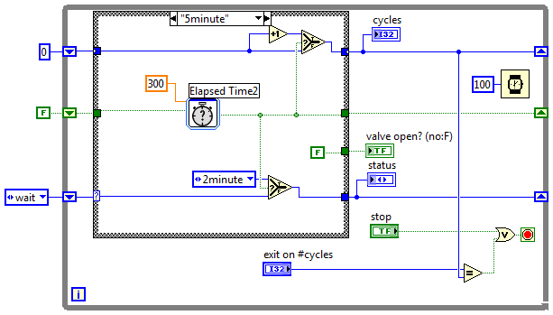

Hello, I am new to coding with Labview and I am trying to execute following problems:
We are trying to use automated valve so that when program starts, the valve will be opened for 2 minutes then closed for 5 minutes - repeating this cycle until program is stopped.
I found some example on-line for a code that control on/off time of LED using the flat sequence structure (attached). It controlls the boolean so that it's on and off for certain time. The problem is, how do I interface this with DAQ assistant for the valve? In other words, I need to make the continuous sequence of on-2 miniutes off-5 minutes as an input to DAQ assistant so that will communicate with
the valve, but I am not sure how to do that.. I have attached the image of where I am at right now.. Any advice will be greatly appreciated! Thank you in advance.

The DAQ assistant has an input on its left hand side where you can wire in the boolean value.  If the DAQ assistant is run in the loop, it should update with each iteration of the loop.

Thank you so much for your reply.
Again, I am very new to labview coding so this might be a silly question:
I want the DAQ assistant board to receive both F and T sequentially, at the time interval set by the clock in side the sequence structure - so in this case, do I connect both F and T out of the sequence structure to DAQ assistant board input? Also, when I tried that, I got an error because the input of DAQ assistant board needs to be 1-D boolean array. How do I resolve this issue?
Thank you very much for your help.
(4,299 Views)
stay away from flat sequence programming design...better off with a simple state machine Smiley Wink
