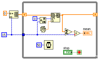

Hi everybody,
I would like to analyze my measurements in realtime as I control a device with the results of the analysis.
Therefor I would like to continuously calculate the mean value of the last 15 values.
I know how to create the array of the first 15 elements, but how can I (after I got the first 15 values and calculated the first mean value of them) delete the first value and append the actual value with every following step? I tried it with the "Replace Array Subset", but it doesn't work the way I do it: (. Can I do all these steps within one while loop?
I think it's not that difficult, but I don't know any solution right now: ( I would really appreciate anybody's help or a simple example, I work with LV 8.0.

Hi Steffi,
this will work without any shifting of elements in memory:
