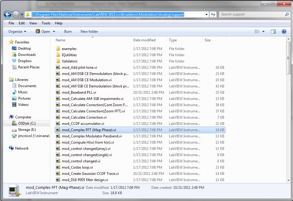

Hi Taylor,
These VIs should appear in the vi.lib folder tree you referenced (within the Labview program files). For instance, here's the location of the 'mod_Complex FFT (Mag-Phase).vi' on my system (with LV 2011 and Modulation Toolkit 4.3.2):
One note - 'Complex Data Waveform' is a .ctl, not a vi, and it's located in the controls folder. If these folders are not appearing properly, you may want to repair your installation of modulation toolkit.
