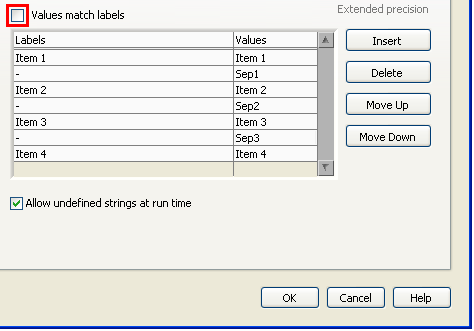

A combo box cannot have duplicate values, so you need to uncheck the Value match labels checkbox and give the duplicate seperators other values (e.g. sep1, sep2, sep3).

@Tushar Jambhekar wrote:
I tried that already, but it doesnt work
Works fine here:
Actually, I would argue that this is a bug in the editor, which should ingnore duplicate hypens if they have a special value.

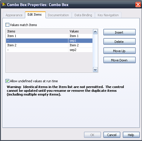

Here's what the "Edit Items..." looks like for the System->Combobox on my system (LabVIEW 8.2):

The version it worked in was 7.0, but I'm seeing the same thing you are seeing in the current beta.
I added this thread to the bug list.
