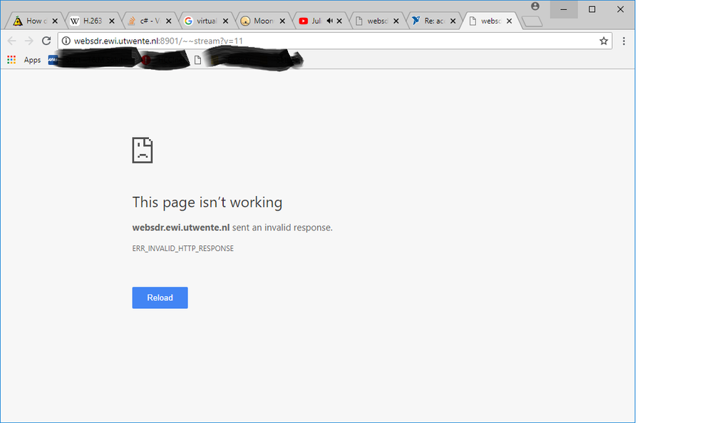

This still doesn't seem to work. I guess it is behind a firewall and only accessible to onsite clients.webpage.png

It is defintely accessible via Internet. Firefox does it.
(3,577 Views)
Hmmm I don't have Firefox but Safari refuses to open that link either, claiming that it is a HTTP/0.9 server. Not sure if the HTTP Client VIs will support HTTP/0.9
