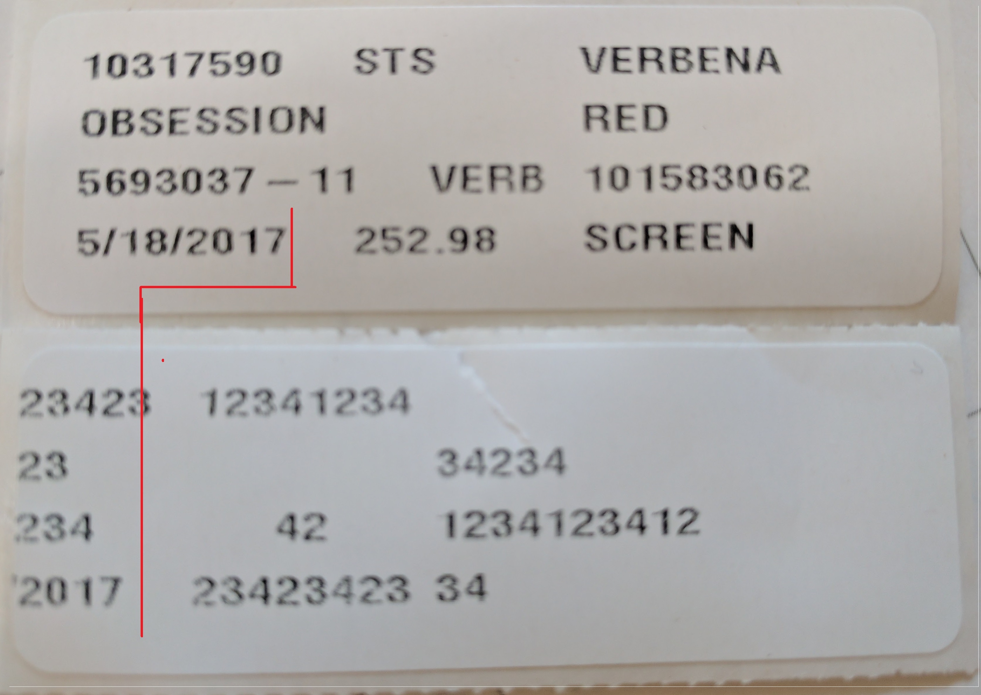

I want to ask you about a weird situation. Here was what happened. We were printing from Zebra GX420t. The command set we use is as shown below.
We tried to print, say, 20 copies of a label. The printing stopped for unknown reason. So we powered off the printer, turned it back on, and tried to print again. But the printing position was shifted to the left, as shown below
I did not pay much attention before, but this issue has happened a few times lately. Do you know what caused the position shift? Thanks.

I can make a pretty good educated guess.  Turning the printer off and on reset the margins (along with a bunch of who-knows-what-else parameters), so printing continued with those defaults instead of preferred setup.  When you have to cycle the power on your printer, you should also restart your printing software (after the printer has come online).

Thanks for your reply.
What you said makes sense. Turning off and back on the printer reset the margin. But what I still don't understand is, the printing software is sending an absolution position of each character to the printer. So why the need to restart the program?

clear print commands missing at the start may be. Try this
CT~~CD,~CC^~CT~
^XA~TA000~JSN^LT0^MNW^MTT^PON^PMN^LH0,0^JMA^PR6,6~SD15^JUS^LRN^CI0^XZ

Thank you. I will put the clear command in ahead of the printing.

There are many parameters that control the position of the label printing. If your print software modified these values and did not save them then when the printer is reset the changed values will be lost. To save the settings permanently after setting the desired values you would send a ^XA^JUS^XZ to the printer.
The likely parameters that are getting changed are the print width (^PW), label home (^LH) and label shift (^LS). The mostly likely parameter is the print width. This value should be set to be the width of the labels you are using. If the printer is a 200 dpi printer and your label is 2 inches the print width should be set to 600. Experiment with this value and once you are printing correctly make sure you save the value using the ^JUS command.
Be careful using ZPL that K C posted. It changes quite a few settings of the printer which may not apply to your environment.
