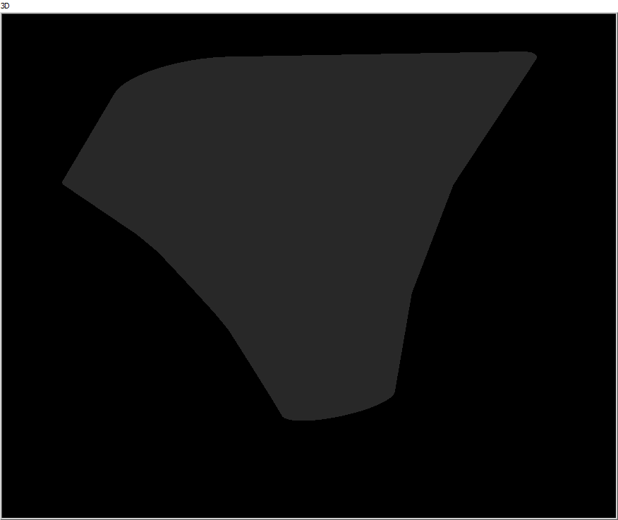

The last point: the process creates a closed surface (see image A), probably because in the last loops it creates triangulations (see image B and zoom B2).
Is it possible to try avoiding triangulation on this side, in order to open the surface?

You can filter out any triangles that you don't want, of course. (In this case, you could filter any triangles where all three vertices have the same specific Z value.)
You posted in a pretty old version (2013). What is your actual LabVIEW version?
Message 23 of 32
(266 Views)
Accepted by topic author M_Ricci
Assuming your LabVIEW version has the conditional output tunnel, here's all you need to do. Try it!

Perfect, thank you Altenbach for your huge support!
Max

On a side note, this entire method only works for a planar arrangement in x and y, i.e. if there are no multiple planes (e.g. a sphere or a donut, etc.). A more general solutions for points in 3D would involve more code (see here).

Dear Altenbach,
I have seen d-dimensional Delaunay is not available in Labview, is there a method to work with 3D points in multiplanes like a sphere or a donut?

I am sure there is. You can look at the 2D LabVIEW code for some ideas (it is just a VI with exposed code!), then expand it to higher dimensions. I have not tried. Good luck!

it looks like there is a "hacky" 3d version...
https://forums.ni.com/t5/LabVIEW/Delaunay-triangulation-and-mesh-generation-in-3D/m-p/1307044#M53772...
at least,  VertArray from "create mesh.vi"  accepts XYZ choordinates
