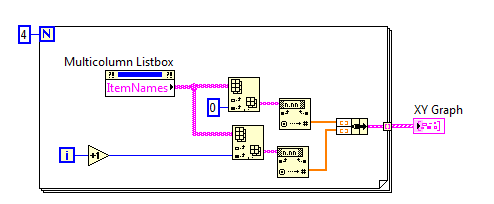

Want  to have an XY graph with 5 plots. Volt1-volt 5 as a function of pressure.
Tried this, but it didn't work. Why ?
(2,992 Views)
Accepted by topic author Michael.Koppelgaard
Hi Michael
You have connected the count terminal to index the array, instead of connected the iteration terminal.
Try the following code.

Ahrr yes - of courseSmiley Very Happy
