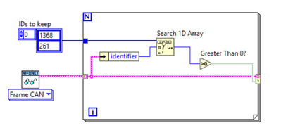

Anyway, I am stuck with another issue which I really cannot go through. I would like to have a "IF CASE" for which the payload of a given frame is shown from the CAN stream. As it is shown in the pictures below, I would like to retrieve only 2 Frames from all over the CAN Cluster, which IDs are "1368" and "261" decimal.
 The program works but as you can see, IDs and Payloads requested aren't shown ever even though I could see those frames to come into the table. I tried to switch one case in dec number thinking thta it could be the problem but nope...
And of course I'm selecting the ID and payload from Cluster table because if I put those indicators outside the case struct they show me all the stuff!
Anyone can help me understanding?
many thanks

This is what I usually do to keep the frames with the desired IDs.
