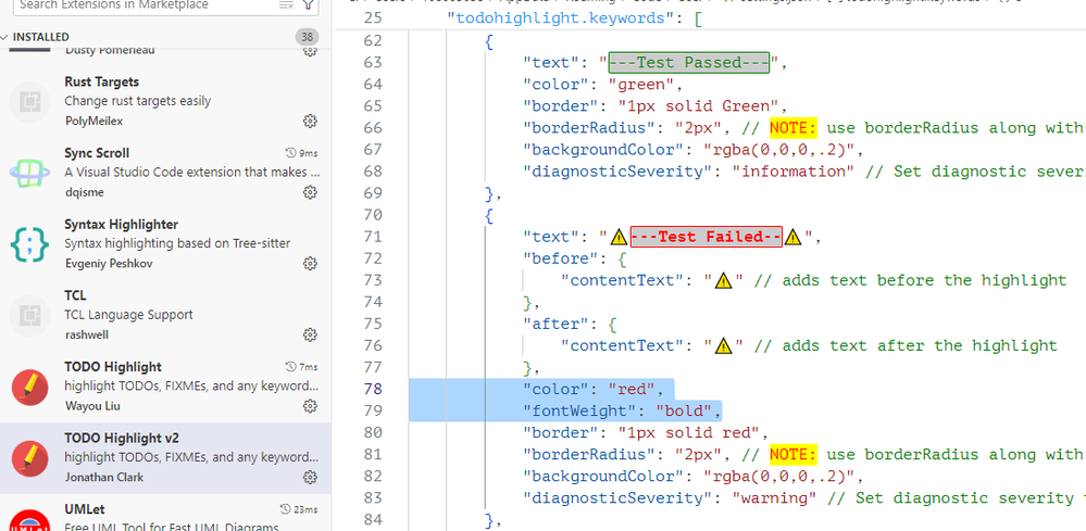

It depends from the viewer you're using to display XML.
Theoretically you can adjust colorizing schema with some advanced editors, like notepad++, UltraEdit, VSCode, or similar.
Message 2 of 12
(3,156 Views)
Just example, how it looks with VSCode and TODO Highlighter v2:
The Settings looks like:

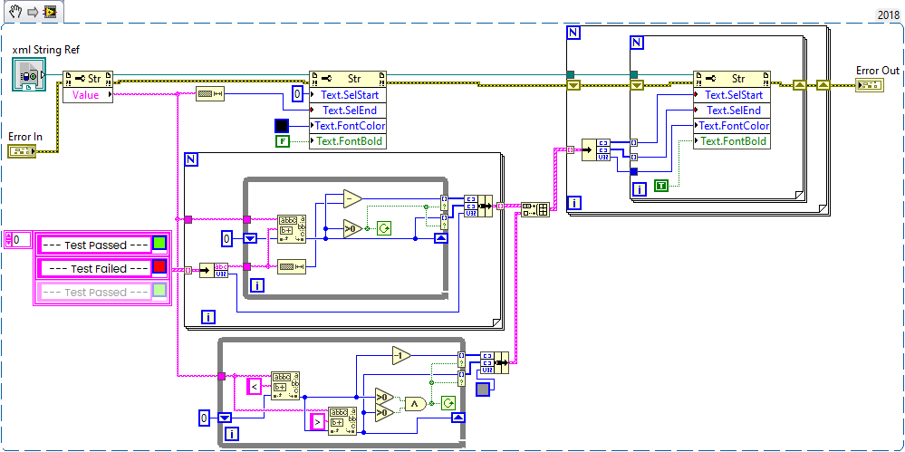

Hi Andrey ,
Yes i want this kind of format only , but these needs to be done by programmatically .
I am working on ATE tester , that automatically creates a report in the backend when all test case sequences are over . That's why i asked for any specific toolkit available already in VI Package manager or  any methods programmatically ?

Its me again. Two small updates.
First of them, small correction for previous snippet (was small race condition and kind of "Rube Goldberg Code". In addition, we can easily highlight XML Tags, something like this:
Then looks like this:

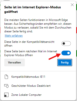

The second part - I was contacted by Mrtechie through private message and he asked me how to do colorization in Edge browser. After some experiments with XSLT I found following.
At the beginning of our XML file we should add link to the XSL Stylesheet:
<?xml version="1.0" encoding="UTF-8"?>
<?xml-stylesheet type="text/xsl" href="test.xsl" ?>
<TestData>

Now the test.xsl file with conditional formatting should look like this:
<html xsl:version="1.0" xmlns:xsl="http://www.w3.org/1999/XSL/Transform">
<body style="font-family:Arial;font-size:12pt;background-color:#EEEEEE">
<xsl:for-each select="TestData/Data">
  <xsl:if test="Status='--- Test Failed ---'">
    <div style="background-color:red;color:white;padding:4px">

(Full XSLT guide is offtopic, lot of tutorials and books are available)
To be displayed in Edge I was need to perform some tricks.
First of them, create shortcut on the desktop to start Edge with --allow-file-access-from-files param as shown:
"C:\Program Files (x86)\Microsoft\Edge\Application\msedge.exe" --allow-file-access-from-files
Now enable Internet Explorer mode (IE mode) button in your toolbar for Edge.
You can access the setting here: edge://settings/appearance#CustomizeToolbar.
Just enter this as URL, then enable this option (sorry for German screenshot):
OK, now you can open XML directly in Edge (drag and drop file to URL), and enable this option:
You need to do this only once, you can select an Option "open this file in this mode forever":
And now we have our conditionally colorized and nicely formatted XML report:
Hopefully will be useful for someone else.

First problem is in Test Result Colour_Format1.vi — your strings are not matched:
The next problem is that you have 20 items in parser, but only 3 in colorizer:
You don't need 20 here, but you need both Passed and Failed strings, otherwise "Failed" will be not colorized:
In general your idea with building colors from the loop is not bad, but I would like to recommend to do it something like this probably, so the colors will be near strings in cluster:
Then it will work again:

Ah, and two separate arrays are not necessary, colors and start/stop indexes can be combined, of course:
Changed VI in attachment, sorry, forgot to attach to the previous comment.
Message 9 of 12
(2,946 Views)
And just one more thing. This will obviously not work for you as expected:
Output string will not contain color info. To do this in SubVI you should pass reference instead of value:
Then it will work if used like this:
