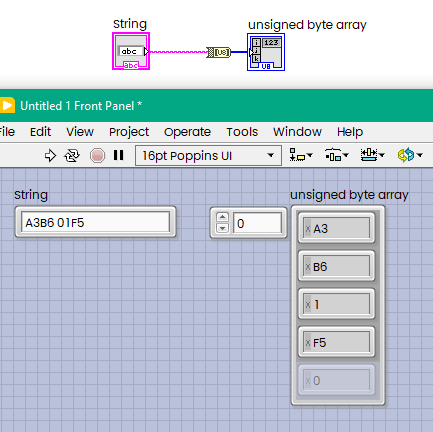

Just switch your string control to Hex display mode:
Then you will get hex representation inside:

@Sina6611 wrote:
I want to send a HEX command to serial port device through NI visa and i use Simple serial program. How can i send HEX command to device.
I've seen way too much confusion of "hex commands", so I have to ask what you mean by this?  There are two main ways I've seen this defined (along with a couple of really weird ways):
1. Raw/binary/hex data - You are sending raw values, with no connection to ASCII what so ever.
2. ASCII Hex - You are sending ASCII characters that, in normal display, look like hexadecimal values.
If the raw, changing your string controls and constants to Hex display (and make the Display Style visible) will make your life 1 billion times easier.
If you are just getting into serial communications, I very highly recommend watching this video: VIWeek 2020/Proper way to communicate over serial.  The second half gets into the raw/binary/hex formats, and you need to be a lot more careful than with ASCII protocols.

@Sina6611 wrote:
Actually, I want to send the following HEX command:
0X0211EE0X03
but I want to know, should it be as an array or as a write buffer?
If you know the full command, just use a string with the Hex Display.  If you need to build up the message with calculated values, etc., I will most often use Flatten To String on the values and then Concatenate String to put everything in the right order.
With that said, I very highly encourage you to watch the video I linked above.  Raw/Binary/Hex protocols need a lot more care than is shown in the Simple Serial Port example in order to make sure you are reading exactly one message.

Hi Sina,
@Sina6611 wrote:
Hello everyone,
I want to send a command to a serial device. The connection works, but it sends false commands. Can anyone say what is the problem? Command is 0X0211EE0X03
Well, we don't have your VI, we don't have your hardware/device, we don't have a manual for your device…
What I can say from your image:
  • When the message contains just one byte ("11") then you don't need an array control: a scalar control would be ok.
  • When this "11" value should be hexadecimal then you need to input 17 (as 0x11 = 0d17) into your array control - or switch the numeric formatting of the control to hexadecimal (and show the radix!)!
  • When using such "hex" messages you most often should turn off the TermChar option for your serial communication! Or use the correct TermChar, which should be 0x03 in your case.
