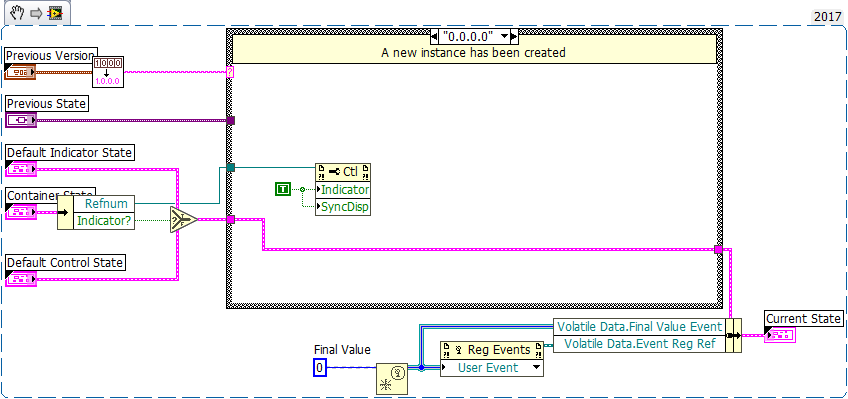

I found the correct solution.  In the Init.vi ability, just set the Synchronous Display property to true.

Wait, what?
Seriously, this works?  Do you also have some special INI settings or is a plain old "In the Init.vi ability, just set the Synchronous Display property to true." enough to rid the world of this annoyance?

It does work.  The "annoyance", and the solution, are actually well documented standard behaviors (but I hadn't remembered it and I had to do some digging to find it).
See: https://www.ni.com/docs/en-US/bundle/labview-api-ref/page/properties-and-methods/vi-server/generic/g...

Well, yes, I'm aware of the "Synchronous display" option for controls and indicators.  But typically one can right-click on an instance and choose whether it is synchronous or not (usually under "Advanced".  This option (AFAIK) does not exist for XControls, hence needing to set it programatically.
I have had several discussions with NI and nobody ever mentioned the ability to set an XControl to synchronous in the Init VI.  I've even started an Idea Exchange idea on the topic.  I tried out all kinds of experimental INI settings (at the behest of NI) all to more or less no avail.

Synchonous Display is available for all controls; including XControls.
It's available both in the context menu and in property nodes.
