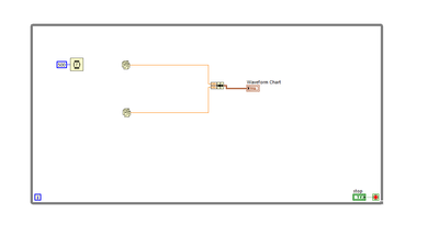

Dear Community members,
I am having a hard time with fixing the timestamp on waveform chart. I am sharing a pseudo code of my problem. I am trying to get multiple plots on the wavechart. I am bundling all the data and passing to waveform chart. I also set the properties as "system time" so that it gets time stamp on X axis. However, for some reason, the time stamp starts from 1903.
So I tried "build waveform", it fixes the issue with date and time. However, I cannot add multiple plots in it.
Can you suggest a solution for this? Thank you.

Just set the offset and multiplier for the x axis accordingly:

In your Chart, did you specify the X axis as "Absolute time", and did you plot your data as a 1D (or 2D if multiple channels) Array?  Are you in Alaska?
The reason your Time axis starts at 4 pm on the day before 1 Jan 1904 is that corresponds to t = 0 in Time Zone UTC-8, which corresponds to midnight on 1 Jan 1904, the "time 0" for LabVIEW's TimeStamp "time" data type.  In the US, Alaska is UTC-8.  If you change the Chart to plot "relative time", the X axis values would start at 0.
That chart can accept an array of waveforms, each element being a different plot.  Use a FOR loop or Build Array to create this array.
Here is an example from another thread:
Message 4 of 11
(3,088 Views)
This will dramatically increase the complexity of the underlying data structures because each point is basically it's own waveform with its own t0 definition! I really don't recommend that for typical use. You might want to do that if the points are not spaced equally in time, but that's obviously not the case here, where dt is a constant 0.5s
After defining t0 and dt as I showed earlier, you can easily add as many plots as you want, either as an array or cluster. My picture above already shows a chart with two traces. That's all you ever need! Keep it simple!!!
