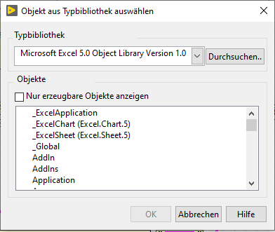

I tried fixing it by choosing the right Excel Object Library in the ActiveX-reference constant. To do that I followed this manual: https://knowledge.ni.com/KnowledgeArticleDetails?id=kA00Z0000019KZNSA2&l=de-DE
But I do not achieve the results shown in step 5. After choosing C:\Program Files\Microsoft Office\root\Office16\EXCEL.exe to link Labview to the right Object library for my Excel-Version the following Object library is selected:

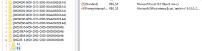

The  Application (Excel.Application.16) option I need to access the Excel-Application is not available. from looking into the registry I know there should be another Object library (16.0) but it is not choosable in Labview.
Is there a way to get the attached example VIs working for Office 365? Or alternatively is there a solution that offers the same functions as the example VIs but uses the Excel 5.0 Object Library that is auto-selected when choosing the EXCEL.exe file as described above. Using the report generation toolkit is not an alternative because it is apparently not compatible with Office 365.
