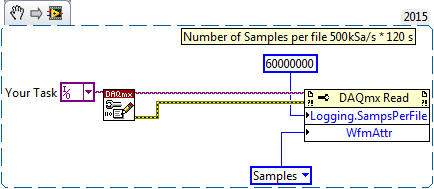

Can't see your code, I only have 2015.
I suggest you look into the functions contained in the snippet. It will do the logging automatically for you, in TDMS format. No need for another loop.

I am having trouble for some unknown reason reading your VI. Attached is an example, you can find it in the example finder that should show you how to do automatic logging. Basically, delete your bottom loop and before the task start configure logging as you see in the example.

Look at the Modified code I am sending, I haven't had a chance to look at your VIs yet.
There is a property node that will break up the files automatically, I added it to the original example.

Accepted by topic author Amartansh13
This example here is for one file and one channel, you should be able to loop over this automatically. The bottom comment should be channel name, not group nameby the channel name in control.
