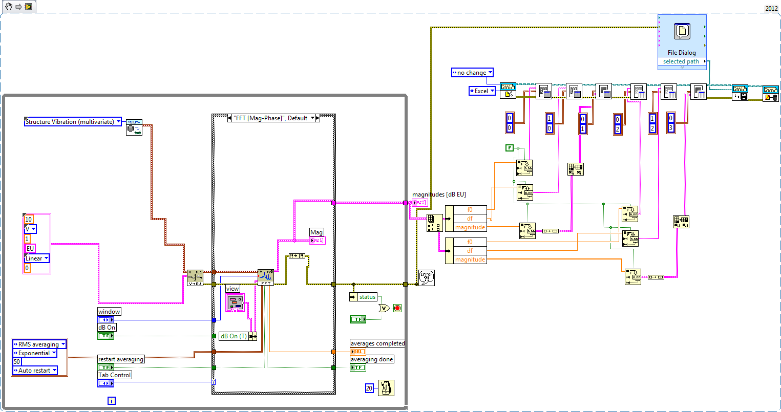

I am using LabVIEW7.1 and am trying to write to excel. The issue is the source is a 1D array of cluster of 3 elements. Not sure where to begin on tackling this. It will be coming from the input to "mag" graph. The top most wire on the FFT[Mag-Phase] tab.

I'm not sure how convert "1D array of cluster of 3 elements" into something usuable without losing data.

Hey thanks for all the feed back. I've previously tried the unbudle feature but it doesn't work. When I click create at the mag output off the "FFT.VI" it wants me to create an array. Maybe I am overthinking this. Like Jean said, a cluster is 2 scalars and a numeric array but that cluster is an array. That's where I get confused.

as you have an array of waveforms going in, you have an array of the clusters coming out
so first you need to index the arrays (for example by an autoindexing for loop) and then you can unbundle

That sounds like it could work, I will give that a try shortly. I've been messing around with an "array to cluster, then "unbundle by name" to the cluster and then write the magnitudes. I've tried putting it in the "case structure" and in the "while loop". both gave me errors with my sampling frequecy in my "gain and phase" VI. Does it need to go outside the "while loop"?
To implement Jean said, where would be the best place to place this "for loop"?

So i've tried indexing, then the unbundle. the data that comes into excel says "data could not load completely" and there are a bunch of zeroes.
Is there a better way of getting the data from both signals to excel, have 1 column be the magnitude, the 2nd column be the frequency its at?a total of 4 columns and to know which is which.
I simplified the code a little and will add everything back later. My priority is to just be able to read the data in excel.

as a simple solution, here it is, unfortunately I cannot backsave it to 7.1, so here it is as a snippet, so you can copy it
I use the report generation toolkit for exporting proper excel data. In this example f0 and df go into the first column of the excel file under each other then a column of magnitudes, then the second f0 and df and then magnitudes
If you go on with save to spearsheet, you need to use arrays, so you will end up a bunch of useless zeros.
Of course it could be refined a bit more, bit it is a starting point
