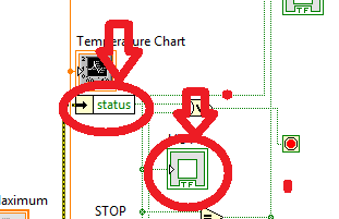

Unti.pngHi everyone,i can't find this symbols in labview . Can anyone know where are these symbols in labview ?

The one with Status is an Unbundle by Name.
The other one is a boolean indicator, perhaps some square LED or a checkbox?
