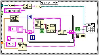

I have a 2-D Array of DBL data coming into a case structure which has 6 channels of DAQ voltages. I want to write that data to a file with timestamps before each row. I posted my attempt below. This is what I want the excel file to look like when opened:

Why not use Write to Spreadsheet File?
What you need to do is create your array of times as a string, and convert your array of double day to a 2-D array of strings.  Build those arrays together (or possibly insert the 1-D array of time strings into the first column of your 2-D array of data strings.)  Then write the 2-D array of strings out using Write to Spreadsheet File.

You actually have a 1-D array of strings coming out of that inner For Loop now.  But feeding it to that concatenate string is immediately flattening it to a single string.  But you could also change that shift register to an auto-indexing tunnel.
One problem with that inner For Loop.  You are running that as fast as it can.  So in all likelihood, every element of that string array is going to have pretty much the same time in it.  Is tha twhat you want?

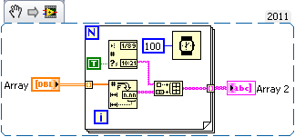

You can do it by the following way. just write the output array to a spread sheet file.
Message 8 of 22
(6,107 Views)
Does this take into consideration the timing of my acuired data? Where do you get 100ms from?
Message 9 of 22
(6,104 Views)
It doesn't correlate to your timestamps.  The first timestamp is going to be after the last sample you've acquired has already come through.  He made up the 100 msec because you haven't said what the timing is.
