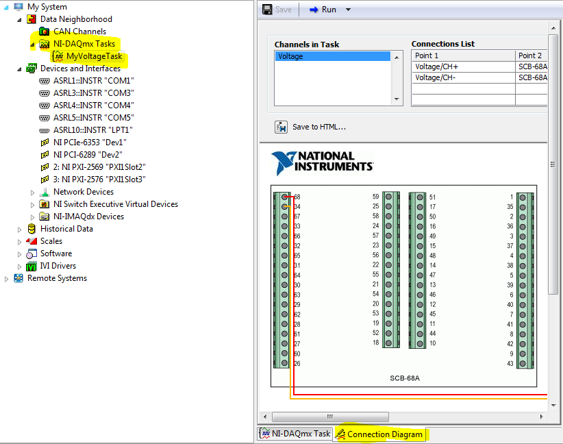

I have a new PCIE-6323 card in a new computer that is replacing two PCI-6221 cards in an older computer.  Connector 0 has a SCB-68A, and connector 1 has a SCC-68.  My problem is that when I go to set up tasks in MAX, there is not a tab to show the wiring diagrams like it used to when I used the 6221 cards.
I am running 2013 LabVeiw and the MAX is version 5.5.0f0.
(3,907 Views)
Hm, it seems that the wiring diagram was indeed moved away from the device and its terminal block configuration.
As a workaround, you can create a task using the IOs you want to use. Within the task, there is a tab called "Connection Diagram".

Norbert,
Can you clarify your work around.  I have created a task, selected the IO but still no terminal block configuration is shown.

Norbert,
I can now see the connection diagram for the inputs but not the outputs.
Can you see a connection diagram for an output task?

TEK,
no, for AO, i dont have the Connection Diagram either.
For the xxx-68 terminal blocks, afaik they have the same pinout numbering as the device. So looking for the device pinout (available in MAX via the device) should give you the correct numbers for wiring AO.
