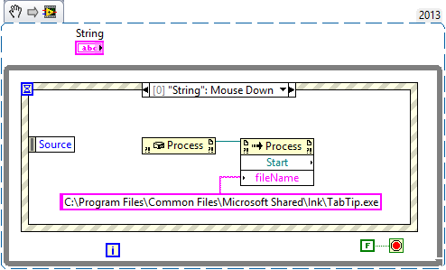

I'd split the problem up into two problems. I did minor proof-of-principle testing, it might help to get you started.
1) detect when the touch keyboard should appear.
2) show the touch keyboard.
3) hide the touch keyboard.
1) seems fairly easy with an event structure or callback event. Not sure if it is that easy. For instance, clicking the control doesn't mean it actually got key focus. So I think it should be a combination of catching key down event, and checking if the control has key focus.
2) Starting "C:\Program Files\Common Files\Microsoft Shared\Ink\TabTip.exe" works for me. I've read online that it doesn't work for a lot of people, that they actually have to simulate a mouse down on the TapTip window. You have to start it with a .NET process.start method. Starting with the command line doesn't work, as LabVIEW looses focus. You'll find Process in the System assembly, under System.Diagnostics.
3) So on some event (enter key, or something else getting focus), you'd have to kill the process. Not in the attachment.
