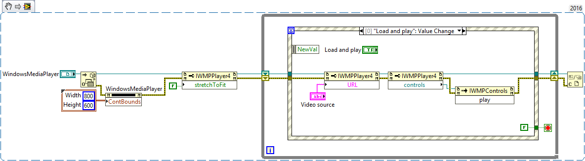

I have searched the forum and other parts of the internet for a solution for an annoying problem with the ActiveX version of Windows Media Player (WMP).
If you embed WMP in the front panel and give the control a certain size, e.g. 800x600 and play a video with different dimensions (e.g. 320x240) the control will resize automatically.
The only 'workaround' I found is to regularly (every 50 ms or so) use a property node to resize the WMP-control.
I have attached an example of the problem below.

@Perreijn wrote:
Hi Guys,

Hello Bill,
Thank you for your reply. I agree that Windows Media Player itself leaves a lot to be desired, has issues and therefore the resize problem also occurs in other programming languages.
However, in other languages you can apparently circumvent the problem by changing the classid of the embedded object. In the Stackoverflow thread somebody more or less solved the problem by changing classid="clsid:22D6F312-B0F6-11D0-94AB-0080C74C7E95" to classid="clsid:05589FA1-C356-11CE-BF01-00AA0055595A". This solution is similar to this example: https://msdn.microsoft.com/en-us/library/aa235212(v=vs.60).aspx.
Also, in C# you can set the uiMode to 'none' and heavily customize the player's behaviour. Doing this in LabVIEW won't work.
I might solve it by embedding the player in a temporary webpage and show that webpage in an embedded Internet Explorer window. But that is an ugly solution.
There has to be an easier way of playing videos in LabVIEW, maybe somebody has experience with a (3rd party) .NET media player?
