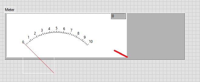

He likely means the fact that the housing size of the meter only can be changed in the same way as other elements when you press the shift button, and that not even fully, with shift button pressed you can expand an object in horzontal or vertical way only and in a way that maintains the width/height aspect ratio. This last one can be very handy when trying to resize a round LED to avoid turning it into an ellipsoid.
It's actually even more sneaky. In customize mode you can resize the backrground in any way you want but the meter area is the one that limits the resizing to maintain the aspect ratio.

When I say that the "aspect ratio is not changeable" what I really mean is that the aspect ratio is not changeable.  I.e. when I change the size, both the height and width change simultaneously, and the ratio of height to width (the aspect ratio) remains the same.
I want to make a meter that is wider, but not higher.

I suppose the logic is that these meters resemble physical meters, and as the needle makes a circle, the meter has to stay to ratio...

My guess is that the reason for the limitation is that the pointer is made by having a line segment pivot at a point; which means that its tip always follows a circular arc.  If the scale were stretched into an elliptical arc, the tip of the pointer wouldn't stay on the scale.  It would be possible to scale it in such a manner that the arc is always circular (by changing the angle covered); but they probably didn't want to spend the effort on something that most people won't care about.
I ended up making an XControl.  Since I only need 3 colors (under range, in range, over range), I used a horizontal slider with 3 pointers: One for the indicator, and 2 invisible ones with fill colors for over/under range.
