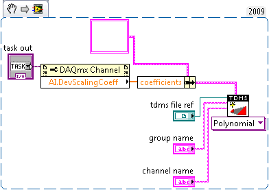

As I just mentioned in the other thread, you can access some of this functionality in the standard TDMS API by using the "Create Scaling Information" VI.  When you describe scaling information in this way, the scaling information will automatically be applied when you go back to read the file (in whatever environment like Matlab, C, LabVIEW, etc).

  3. This is currently available as I mentioned previously via the "Create Scaling Information" VI in LabVIEW 2009.  Then, all you do is call DAQmx Read for unscaled data (U32/I32 in your case) and wire that into TDMS Write.  Then, whenever you read the data back in any of the TDMS readers, it will automatically be scaled for you (thus requiring no post-processing).

I have not know about 'TDMS Create Scaling Information VI'. I have already implemented it into my measurement software for harmonic measurements using Producer/Consumer structure and everything works fine. I also checked how it works with nilibddc.dll and no problems. Thank you for the suggestion.
