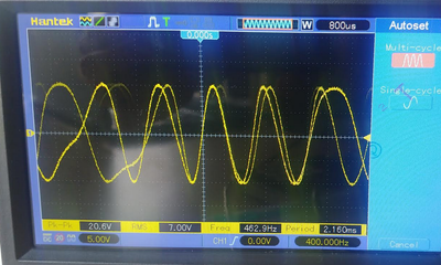

Why might my myRIO FPGA DAC output a non-constant-frequency sine wave after parallel processing is implemented?
Hello, I am working on designing a PLL, and I found the following version online: https://forums.ni.com/t5/Example-Code/Phase-Locked-Loop-PLL-on-a-myRIO/ta-p/3509103?profile.language...
This version showed in the link works well, but I want to increase its speed by implementing parallel processing by dividing the VI into multiple loops. However, after implementing this, my DAC output on the oscilloscope seems to oscillate around the desired frequency even though I have not changed any scaling factors. Does anyone know why this may be? Could it be an issue with my FIFOs?
I also posted this on Reddit, but the LabVIEW forum allows me to include the code, so I am also posting it here as well. I hope that that is ok. If it isn't let me know. The original FPGA VI is called "myRioPLL.vi", and it is under "FPGA Target". The one that I created to implement parallel processing is called "myRioPLL_J3.vi", and it is under "FPGA Target -> Custom".
I have attached snippets of my code below along with pictures of my oscilloscope readings. The first oscilloscope reading is of it running normally, while the second is a capture of a single sequence.
