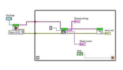

I tried using CLAUDIE_xlsx addon on LabVIEW in order to write and read data from an excel file.
I succeeded with creating, opening and writing to an excel file.
But when after I write text to spreadsheet in excel, I see that in addition to the text in the excel file, there is a blank cells without the excel cells boarders.
This is the blank cells in the excel file:
And here is the LabVIEW connections:
Do you know how I can fix this?
Also, is it possible to read a specific cell from a spreadsheet in excel or only a specific row? if it's possible, how do I do it?

Hi Reshef,
You seem to write a lot of empty strings to your sheet - as far as can be seen from your blurry image…
Yes and yes.
Usually you can do this using ActiveX calls to remotely control Excel.
I don't know how your CLAUDIE toolkit handles those calls - have you read its manual or tried to contact the support?
(3,531 Views)
I've found the problem. it needed a const length of array to be inserted into excel. now everything works fine.
Thank you for your help!
