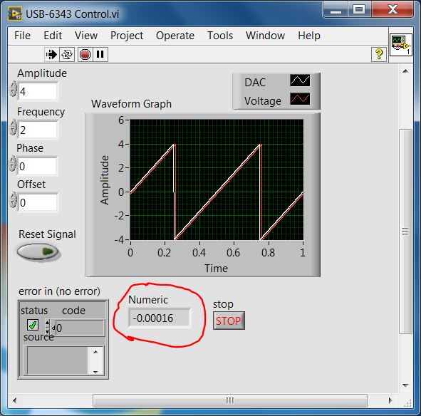

In my setup While loop should be stopped once input signal goes over a threshold.
Fig.1 - Block Diagram, Fig. 2 - Front Panel (running).
As you can see, input signal (red sawtooth) goes over 2.8V (threshold).
So comparator should wire and stop While loop. But it doesn't.
What is wrong in my realisation ?
Also a couple of additional questions:
  1. How the labels of signals in WaveForm Graph are formed - I thought that they originated from signal labels, but it seems not be the case.
  2. When stopping While loop with "stop" button, I hope to find the last signal value in Numeric indicator, but instead find the same value - small value,close to 0. Is it normal behavior for shift register ?
Thanks in advance
Pavel

Overall, i recommend you to NOT use the DAQ Assistant.
However, the question is how you configured the ADC DAQ Assistant:
Is it single point software timed or do you acquire waveforms?
If you acquire waveforms (which i assume), the error you are doing is to convert this to a single double value. That means that you only extract the (i guess) last value of the waveform which is obviously even less than 0.
Norbert
EDIT: To address your additional questions:
1.) The name of the waveform is as far as i know defined in the DAQ Assistant (your configuration). As i obviously never use the DAQ Assistent besides "Quick and Dirty Testing" i am not sure.
2.) Same answer as to why your loop doesn't stop with the signal going above 2.8 V. And please take a look into your image of the waveform graph: The last value of both signals is very close to 0, obviously a little below (esp. the red signal).
Norbert

I've found error in previous case: in "Simulate Signal" number of samples was grater than samples per second.

The VI you attached includes "Simulate Signal" which creates a huge array of data. You simply check the last value, so the issue is the very same as in your original question.
What is the purpose of the whole stuff?
You cannot write some "controller" when working with large arrays as long as time delay is not an issue.
Norbert

Yes, you are right - the problem was in timing parameters of "Simulate Signal" block.
I've changed them in the original setup (with 2 DAQ assistant blocks) and now the original setup works.
What I did - I've merely changed the ratio saples per second / number of samples to be 10 (instead of 1 as before)  in the "Simulate Signal" block.
Strange phenomena ... or probably I've missed something.
