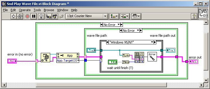

      Today I was poking-around in "Snd Play Wave File.vi" (LV 7.1) and noticed that a VI reference is opened but not closed.  Maybe it doesn't matter, but there's been a lot of talk about why references must always be closed - and I'm sure some should be - but which?
To date, my rule-of-thumb has been to Close only when somthing's been created (by me.)  An example of references that shouldn't (I don't think) need to be closed are in the "Controls" array-of-references property of a cluster.  But sometimes I'm not surewhether I created anything or not.  It probably can't hurt to close everything, but is it necessary?  What about when a property node is used and exposes a bunch of attributes - including a read-only reference, but the reference isn't wired?  Is this a mistake?
Must we hunt-down every stray reference and terminate the poor things?

Here's my take on closing references.  My #1 rule regarding references is to always close them, no matter where they came from.  I have two (hopefully obvious) exceptions to this rule...I don't close static references (like Control Reference, This VI, This App, etc.), and I don't close the reference output coming from an implicit App or VI property/invoke node (you know, the kind where you don't wire the reference input, and thus they refer to the current App or VI).  Everything else I close.
That being said...
There are some references (as of LabVIEW 7.0 and later, I think) that are ok to not close because LabVIEW will automatically close them for you once your VI goes idle (i.e. it stops running, and any VIs that call it stop running).  Primarily, these references come from property nodes, i.e. the "Controls[]" property of the Panel class.  If you get an array of controls on the panel via this method, you will be ok if you don't close them all, because they'll be automatically closed once the VI goes idle.  Even if you get this array in a loop, and you don't close the references, you should be ok, because the property node will return the same references each iteration of the loop, i.e. it won't return a new reference to the same object every iteration.  Again, it didn't always behave this way, but it has since (I think) LabVIEW 7.0...maybe even earlier.
However, for pretty much all other kinds of references, you need to close them to avoid leaks.  This includes any VI reference, like those you obtain from an Open VI Reference, or even those VI references obtained from property nodes (like the example given in the previous post).  Also, *any* reference you get for ActiveX, .NET, or some other non-VI Server interface, needs to be closed.
So, since there are some references that *must* be closed to avoid leaks, and there are some references where it's ok to not close them, it's best to be safe and always close everything (see my #1 rule above).

Yes, the Close Reference function is a no-op on those references I mentioned that the VI will close for you when it goes idle.  You can see this for yourself with a simple VI where you get the Control reference array for the panel, index off a control, read a property of the control, close the control reference, use the *same* reference wire you just closed, and read another property of the control.  The property will read just fine, and you will not get an error out of the property node (like you normally would if you had an invalid reference)...this is because the Close Reference function did not do anything because this was one of those special references that the VI will "clean up" when it goes idle.  I have attached a screenshot of a VI that demonstrates this.
Hope this clears things up a little bit.  Remember my rule though, always close the references, even if they're the kind that don't really get closed.  It's just good coding practice.
-D
