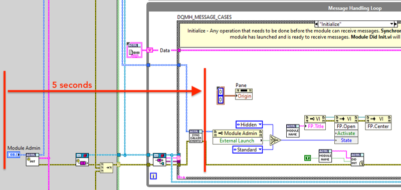

Sorry for being confusing - I wasn't thinking about dependencies here, but rather about the startup mechanism of a DQMH module and its timing. If you delay the execution of the "Initialise" case - or, more specifically, if it takes more than 5 seconds for your module to get to and execute the "Synchronize Caller Events.vi", your Start Module VI will report a timeout error:
This is an extremely-hard-to-track-down error that has cost some of our customers a good amount of sweat and tears. Hence our rule not to put anything into the Initialise case at all, to be on the safe side.
