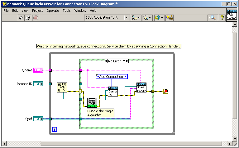

I have used this method extensively and have not experienced any performance issues. The only different between N number of dedicated ports and a single server would be the time it takes to spawn the client processing task. Also, a single server would probably use less system resources since you only have one listening task. Not to mention you don't have to coordinate your port number for each client.
Here is one of our basic server tasks:
And here is the code for the Spawn Handler subVI:
This code was developed several versions back. If I were to write it today I would use the "Start Asynchronous Call" method to spawn the client processing task.

Thank you Mark, very much.
It looks very interesting. I'll analyze the performance.
Only that I do not know the other subVIs displayed (could be my old version of LabView?)
Thank you!
Message 5 of 12
(12,249 Views)
Accepted by topic author ElectroniCHE
I assume you are referring to "Start Asynchronous Call". That was added in LV2011. If you are using an older version the method I posted above works just fine. In fact, we still use that VI (Spawn Connection Handler, which is one we wrote) in both LV 2011 and LV 2012.
