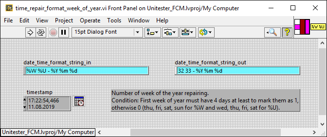

Sorry for sharing for any years not valid code. Here is the new one.
Condition: First week of year must have 4 days at least to mark them as 1, otherwise 0 (thu, fri, sat, sun for %W and wed, thu, fri, sat for %U).
Repaired: Missing Pad using zero when formatting week number back to string.time_repair_format_week_of_year_1.png
