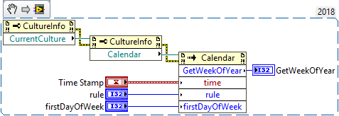

The ISO 8601 standard for weeks states that “week 1” is the first week of the year with a Thursday in it.  Not sure if that's exactly what you want, but it would be nice if LabVIEW had that as an option.
If you are willing to use .NET there's an function that's more along the lines of what you need, with some configurable parameters to refine it:
