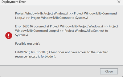

Hi!
First, thank you for your answer and for your help.
I have my RT target. When I deploy Labview projects directly, there is not problem. But, when I try to deploy from Veristand, apearse the same error:

The VeriStand Gateway encountered an error while deploying the System Definition file.
Details:
Error 363516 occurred at Project Window.lvlib:Project Window.vi >> Project Window.lvlib:Command Loop.vi >> Project Window.lvlib:Connect to System.vi
Possible reason(s):
LabVIEW: (Hex 0x58BFC) Client does not have access to the specified resource (access is forbidden).

Hello Everyone,
I am facing the same issue. Though changing the admin rights in webdav and controller admin rights, I am still facing it and unable to deploy the sysdef files in verilog due to client authentification issues. Here attached the image FYI. Any solutions or suggestions would be greately appreciated.
Thank you
Mahesh K
