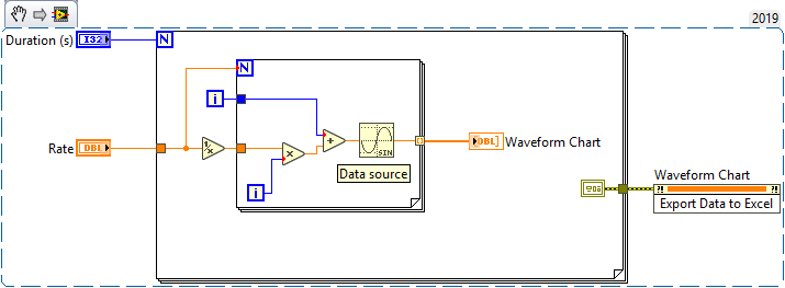

I'm trying to export a Waveform chart I have to an Excel table using the built in property node. The graph records at rates requested by the user anywhere between 10Hz and 10kHz. I've increased the size of my chart's history a great deal to make sure that that is not an issue, but no matter how massive I make it (up to 1,000,000 waveforms at the moment) both the 10Hz and 10kHz settings both only give the last 5 seconds of my ~10 second recording time. It doesn't seem like a space issue, is there some setting I've missed that I need to change? I can't post any pictures or VIs unfortunately, so if I've left anything unclear I'll try my best to describe it.

Are you setting the X Axis to autoscale? If not, then if you're using the node I think you're describing (equivalent to right clicking the chart and choosing Export > To Excel) then only the visible data is exported, not all stored/held data.

Here's an example that demonstrates what a) I think you're doing and b) the 'problem' I described earlier. (Saved for 2016).
Here I'm just using the Error Constant to sequence (because I didn't want to drag a sequence structure...)
Changing the difference between the first and last values of the X array (before running) will produce a different number of samples in the Excel sheet that opens.
