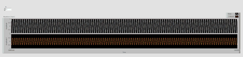

dsb@NI wrote:
this is a realy nice demo!
I would visualize the raw and the filtered data in a stacked chart, for comparison, e.g.
Spoiler
when set the .vi to "run continously":
Message 5 of 10
