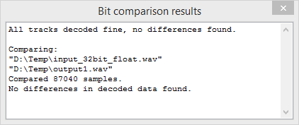

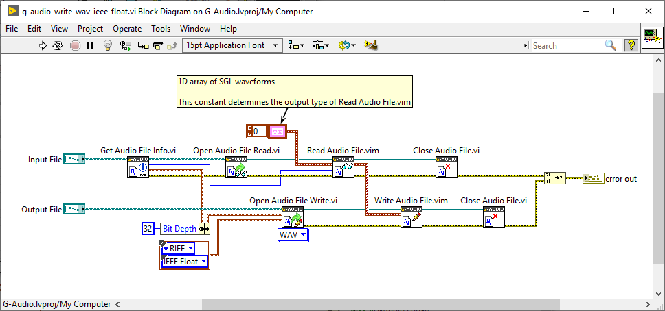

Unfortunately LabVIEW's sound VIs only support writing 32-bit integer wav data, not IEEE float data (and only 16-bit integer wav under Linux / macOS).
I've written an audio library for LabVIEW called G-Audio which can read and write IEEE float wav data. Here's a quick example (with VI attached). Note the IEEE Float input to Open Audio File Write.vi:
And the results in foobar2000:
The library is written in LabVIEW 2020, but if you don't have access to that version I can try save it in LabVIEW 2018.

Accepted by topic author mxarai
Hi mxarai,
Attached is the library saved in LabVIEW 2018. It includes the example VI from the previous post, plus a number of other examples in the Examples folder (see Write Audio File Example.vi and IEEE Float Compare Example.vi to help you get started).
Please let me know if there are any issues opening it. I had a heck of a time saving malleable VIs for previous version, and ended up using a conversion script to convert most of them to polymorphic VIs.
